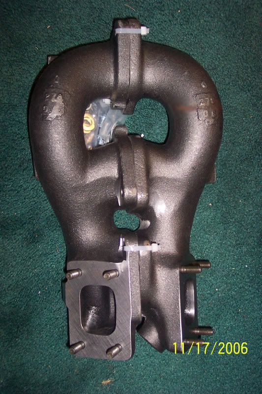

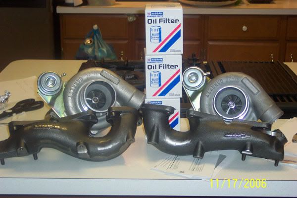

Message I FINALLY got some Mike Smith exhaust manifolds.
All thanks to Bernie!, He said if he got a set, he would let me get in on them. He kept his word and I am a happy man!
First, I would like to say that these manifolds are super high quality.

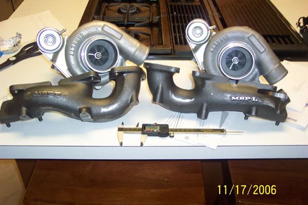

I measured the inlets on the runners..
All of them are EXACTLY the same size
38.45mm X 50.15mm
Turbo collector measured
49.85mm X 38.52mm (The exact same size on my Turbo collector flange).

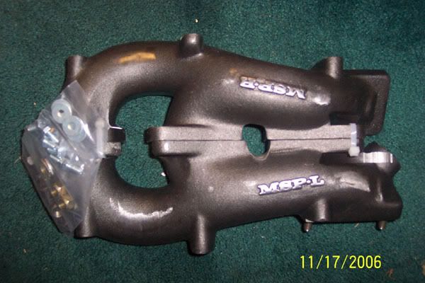

This just shows how great of quality these things are. I mean these things are so symmetrical. Both have the EGT bosses in the proper location to get accurate readings with plenty of meat to get a good solid tap, EGR permanently deleted (on my set).
Another note on the quality, The bolts, nuts, washers and studs are all pre-wrapped in their own separate baggies. Even the washers that are for the corner exhaust manifold shortend stud is trimmed off to fit. It is somthign that could be done in a few seconds with a grinder. BUT, This again just shows the attention to detail and quality.

I just need to get on the ball with my 2.5" aluminum IC/Intake piping and Inlet pipes (Steel,heat wrapped) for the GT28RS turbos I'm using.. Should be together shortly.
I was planning on sending these manifolds out, along with my turbine housings to get extrude honed. But for these manifolds, there is no need. The internals are already oh, so smooth!
Bernie is a great guy to deal with as always.. I got lost on the way down to his house.. and he had to wait up for me to get there, and even offered me some beer :) He even gave me some of the elusive 60u00 filters. ( I swear I think he has a little sweat shop going that are still producing these things.. or he must have an airplane hanger full of them, lol)
I'll let the pictures speak for themselves.
Notice the pre-trimmed washer
